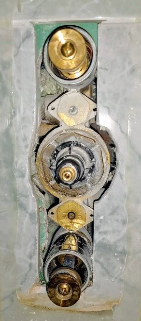

I have a 20-year old house with Nefit HR Ecoline CV-ketle + 120l boiler combination on the attic; single bathroom on the 1st floor (bath + shower cabin + 2 sinks). Previous owner never provided a map of the piping but I'm working that out. So I see 4-way hot water manifold at the exhaust the boiler, with identical 1/2" OD pipes. The inlet valve to the boiler fully open, seems OK. I can't measure the inlet pressure at the boiler but hot water pressure in the house is ... not impressive. Could be the incoming cold water, could be the pipes are plugged, could be the boiler, I might have a hot water leak etc etc etc
The problem is the hot water pressure in the shower cabin is VERY low (the cold water pressure in OKish), while on the other 3 faucets it seems OK - or at least it's definitely higher.
I know for a fact there are no valves b/w the boiler outlet and the shower cabin rough-in valve. So I cut the tile to get to to the rough-in valve and that one is some old Grohe monster with what seems like 52mm (2"?) nut that I can't remove (see pic) - I ordered a box spanner from Amazon... of course the isolation/needle valves on both sides were open OK (I played with those too for no avail)
Anyway, my questions are the following
1)What is the chance I'll find the rough-in valve plugged/worn/smth. It seems probable as the other faucets in the bathroom seem ... better. But I'm worried.
2)As the hot water pressure in house is substantially lower than the cold water - how probable is that the old boiler is plugged, and is there a way to flush the hot water system without. I know boiler is super old and have to go but that's 2.5-3K euro that we're not very happy to dedicate
3)Last one - if I upgrade directly the whole thing (i.e. for example Nefit Trendline 30kW CW5 + 120l boiler) can I combine CW5 ketle with CW6 boiler?
Thanks a ton. Quite stuck here ... with the family showering in the bathtub
