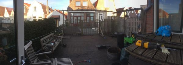

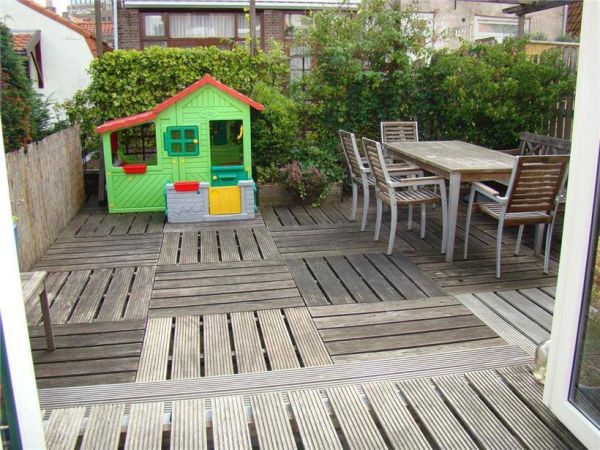

I have been doing renovations to our house here in Haarlem since December (bought the house in September 2013). The bottom floor is a large garage, and the back part of that is a terrace on the first floor.
It is difficult to get information in English as this design is not common in the UK or US. Normally, if you have a flat roof, you would not have a decking on it. I am trying to learn Dutch, but it is not so easy. :)
Picture when we bought the house:
Picture in it's current state:
The roof was never insulated as it was always a cold room (no heat). There are no leaks. I'm not sure of the material, but I believe it is bitumen.
We plan to install a large skylight at the back (5x1m), and we also need to insulate the roof. I am wondering is the current coating OK, or should I replace it with something better? Or will I simply cut out the hole and coat the pieces around the skylight?
If I can keep the coating, how to insulate? Can I just add some isolatie from below, rockwol or similar. Or is it no so simple?
And finally, could anyone suggest, or let me know what the name is for a contractor to check the structural rigidity of the roof? I would like to know how much weight it could witthold (maybe a hot tub? tegels?)
