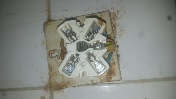

Tom345
We need photos of your fuseboard and your Perilex wall outlet (both opened).

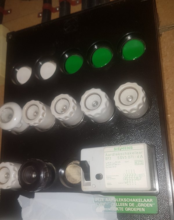

WeirdoSon
Hi Tom,
Please find attached.
I hope this helps.
I didn't know if the fuseboard you're asking for is the one in the pic but please let me know if you need further pictures🙂
Thanks a lot bud!

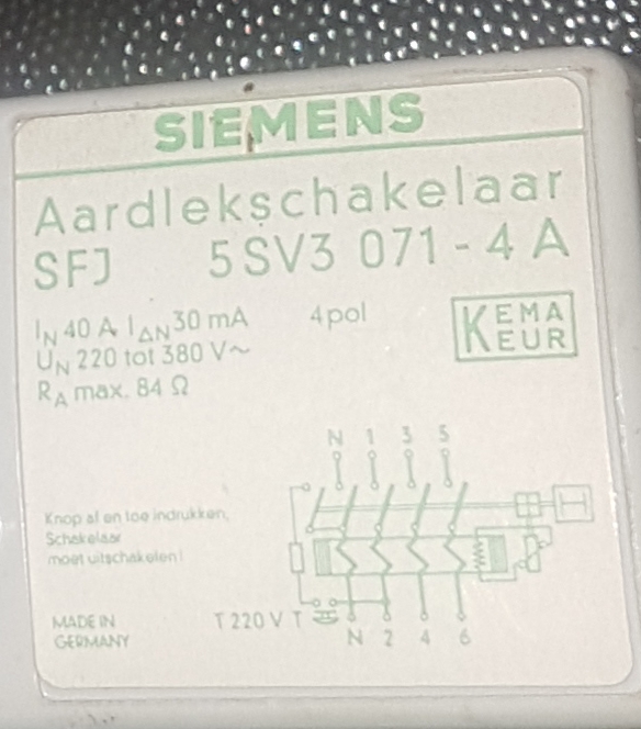

Tom345
Oh, that is an old fuseboard. Consider replacing it, as as the RCD will not give you the same level of protection as a modern one.
It also is a bit weird. Your Perilex outlet appears to be wired 2x230V, while it looks like your fuseboard is three phase. Are the two fuses left of the RCD (black and white) for the Perilex?
If you have only 2x230V, this cannot deliver enough power for your 11 kW cooker.
Could you please open your fuseboard and place a photo of its insides?

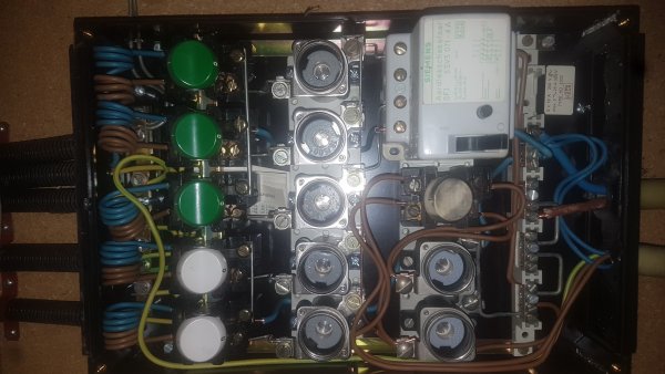

WeirdoSon
Hey Tom I can't tell if those two are indeed for Perilex but here's a picture of the open board:
Tom345
Ok. This is a single phase installation. That means that it cannot deliver enough power for your 10.8 kW cooker. The maximum you can connect is 7.36 kW.
