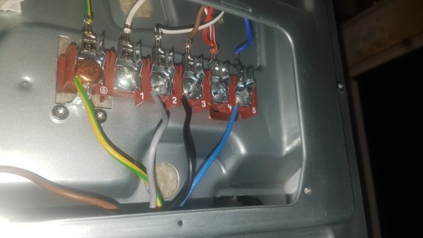

Hi guys,
So the lady who sold me the oven told me to come here for help.

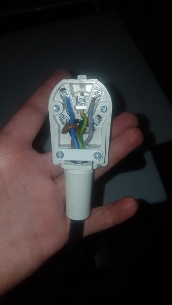

I got the oven without a plug just the cable. Bought the Perilex head from Gamma, then got stuck.
Please have a look and tell how to connect it correctly (please don't tell me to call a pro i want the combination).
Btw I found the brown one unplugged from the oven, so even more confusing.
Thank you so much in advance!

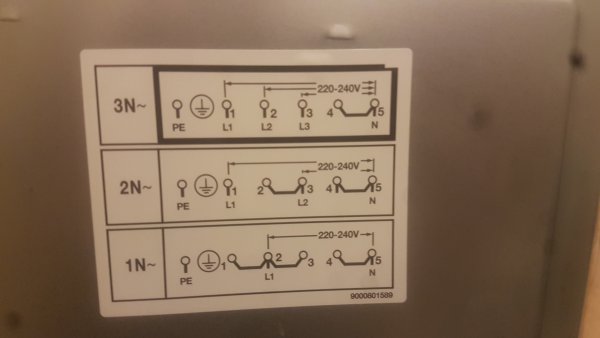

It also is a bit weird. Your Perilex outlet appears to be wired 2x230V, while it looks like your fuseboard is three phase. Are the two fuses left of the RCD (black and white) for the Perilex?

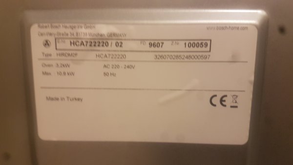

If you have only 2x230V, this cannot deliver enough power for your 11 kW cooker.

Ok. This is a single phase installation. That means that it cannot deliver enough power for your 10.8 kW cooker. The maximum you can connect is 7.36 kW.
If it is your own house, you can upgrade your installation to three fase. That upgrade would include the installation of a new fuseboard. As yours is very outdated, replacing it, is a good idea anyway.
If you rent that house, you need to ask your landlord, if he/she is willing to upgrade the installation.
The other option is that you place a loose oven and hob. The hob, you connect to your Perilex, the oven to a normal wall outlet (preferably on a separate group).
